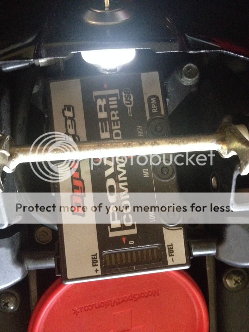

Post Options Post Options   Thanks (0) Thanks(0)   Quote norty303 Quote  Post ReplyReply Direct Link To This Post Posted: 16 September 2015 at 12:27
Here is the connection on the PC end

J@Y View Drop Down
Joined: 08 March 2013
Location: North West
Points: 1156
Post Options Post Options   Thanks (0) Thanks(0)   Quote J@Y Quote  Post ReplyReply Direct Link To This Post Posted: 16 September 2015 at 12:36
Ahh, thank you for the info. It is actually that simple then! Will be interested to know how these perform. I have an HM plus on my race bike, so this would be for use on my road bike.
